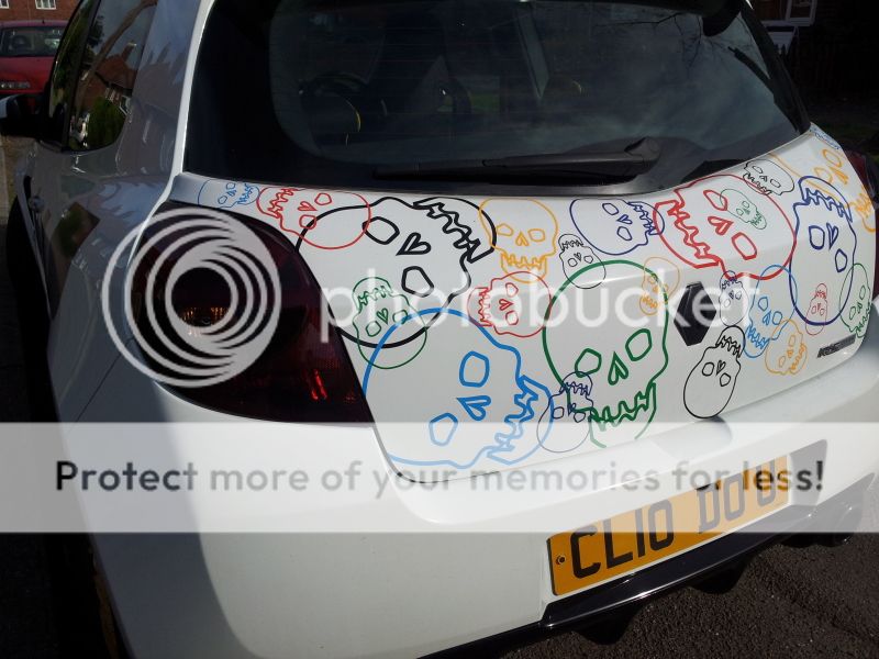

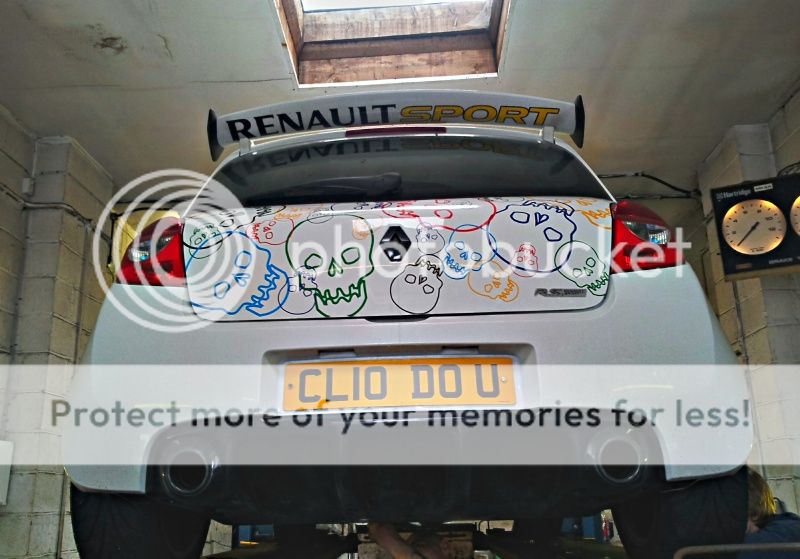

    And then I thought i'd play around with some stickers...

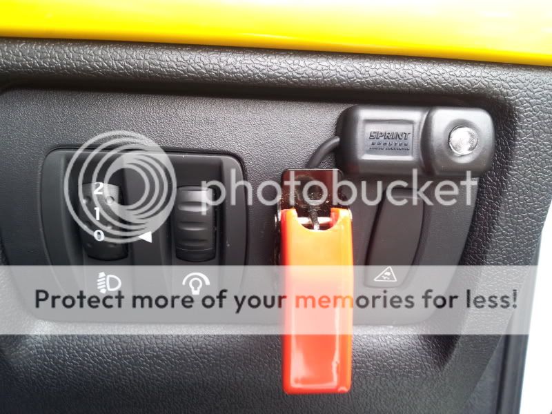

    Obviously by this stage the Clio wasn't quick enough so this switch appeared...

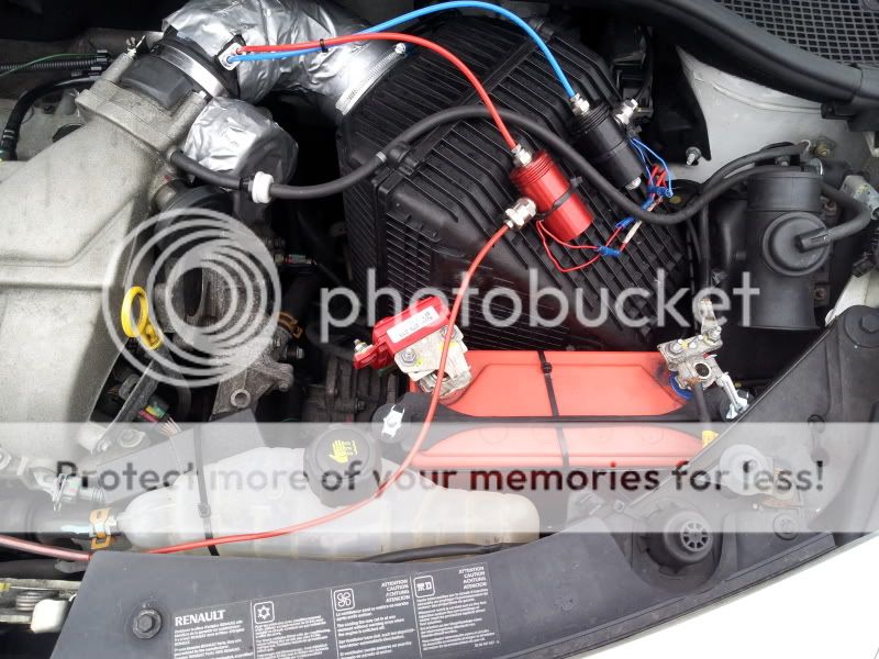

    Yes you guessed it I stuck a 50bhp shot of Nos on it, controlled by a Max Extreme progressive controller...

    As many of you are aware the Clio's throttle response is crap so a Sprintbooster was fitted...

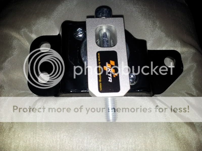

    Full set of Ktec/Virbatechnics engine mounts.. just one shown here

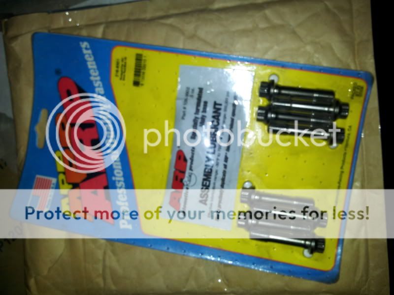

    ARP Rod Bolts

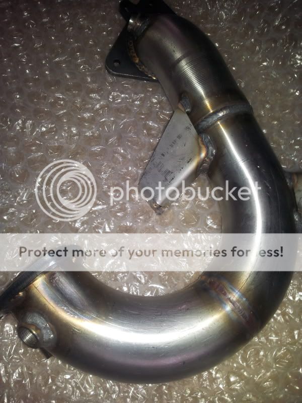

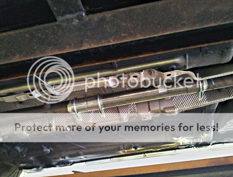

    Ktec 3" Decat Down pipe

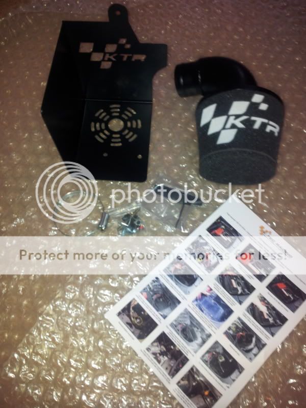

    Ktec Induction Kit

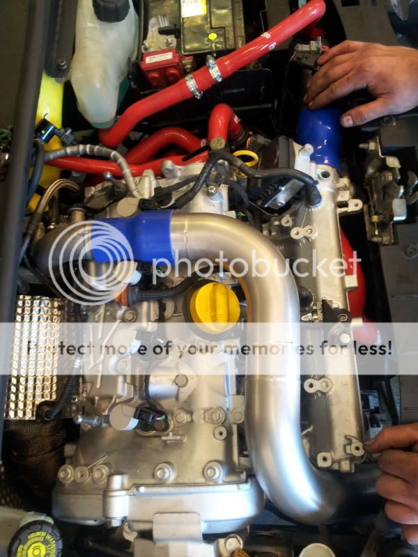

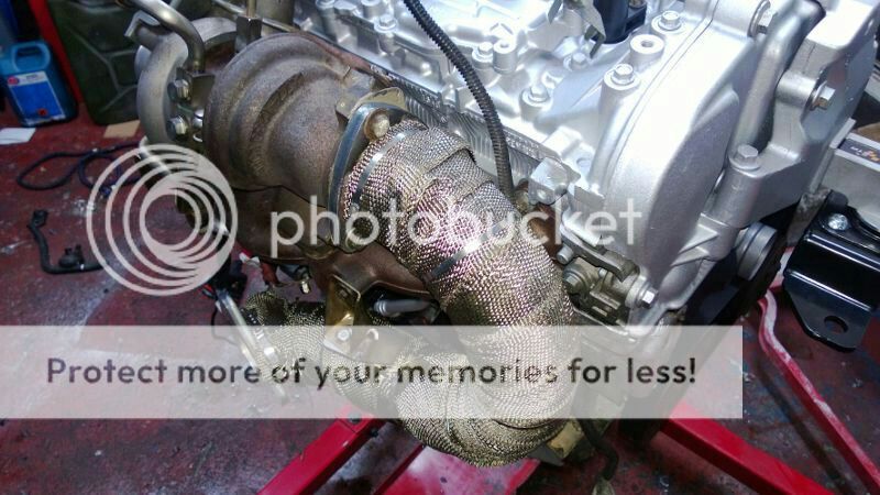

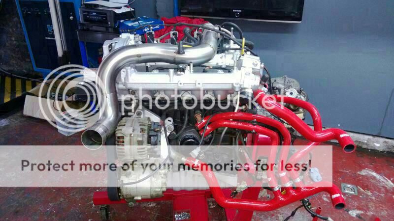

    Next up was the engine build... complete with Forge Silicone hoses and titanium exhaust wrap... and of course the development of a massive 63mm hard pipe kit. The engine build, development hard pipe kit and wiring was completed SC Auto Electrics in Bolton.

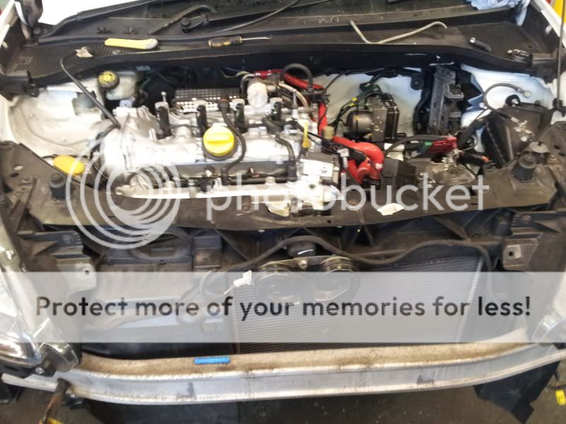

    Once finished it was time to shoehorn everything in, the full install was done by Noble Motorsport in Chesterfield.

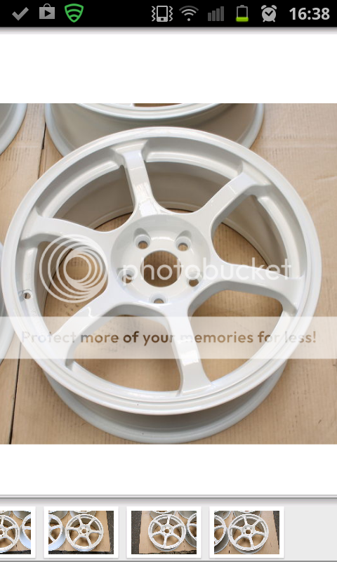

    Whilst this was happening I found a bargain on eBay and ended up with a set of Rota Boost, 17x8j ET45

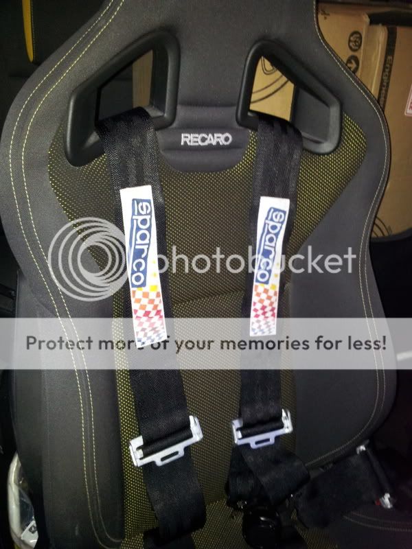

    And some Sparco harnesses also courtesy of eBay

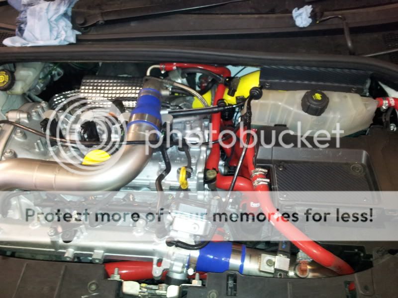

    Ste cleaned and built the engine with the ARP rod bolts, putting on everything from the turbo, decat, exhaust wrap coolant hoses and custom Meg/Clio wiring loom. This was then delivered to Nobles.
    Noble Motorsport had already taken out my old engine and gave the engine bay a proper clean. They put in the new clutch and put the gearbox on then popped the engine in.
    Once the engine was in they then set about fabricating the turbo heatshield, the custom braket for the expansion tank and basically wired everything up ready to go.
    The job that Nobles did was as expected very professional and very OEM so understandably I'm very happy with their workmanship.
    The car then went back to Ste in Bolton for the mounting of intercooler and the massive prototype hard pipe kit, at 63 mm this kit is around 12mm larger than the ktec and forge kits that are. Its also a work of art and has less joining points.

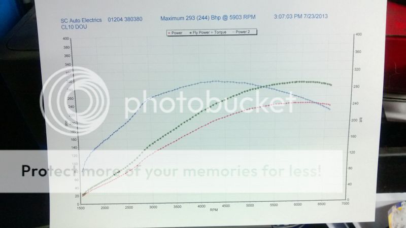

    The main issue has been the availability of the correct R26 ecu, gladly this was sorted but was a headache. The work by Ste been outstanding and very OEM, overall I am ecstatic with it all and with everything that Ste and Nobles have done.
    You've only got to look at the figures and the graph to see that Ste knows his onions very well indeed.
    293bhp
    297lb torque
    As I'm still running the Clio gearbox I asked Ste to keep the torque close to 300lb so I'm sure it could've made more. [​IMG]

  6. Very tidy looking conversion....bhp seems a bit optimistic though :smile:

    Bhp figures will always cause controversy. Lol
    I was expecting upto 280 with the goodies that have been put on. My tuner reckons the 63mm hard pipe is helping as its cooling the turbo much better and therefore making it more efficient, ktec's and the forge kit at.51mm is still quite restrictive to airflow. I know his rollers are pretty good but I will be sticking them on Nobles rolling road for a comparison.

  16. Looks good, torque curve looks nice for not bending rods too.

    I was very pleased with the torque curve when I saw it, so smooth and I guess time will tell with the Rods.
