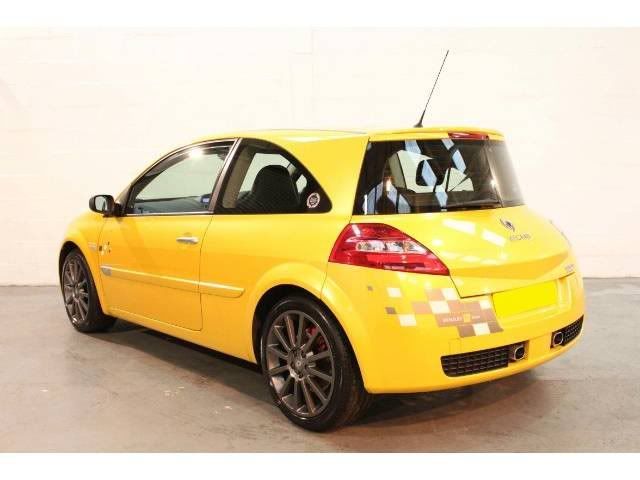

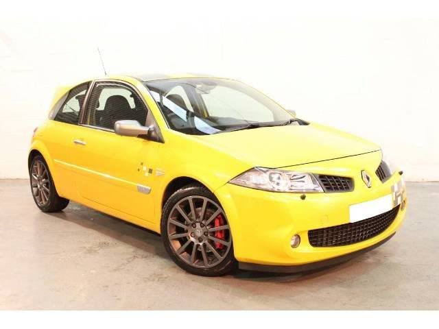

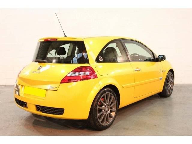

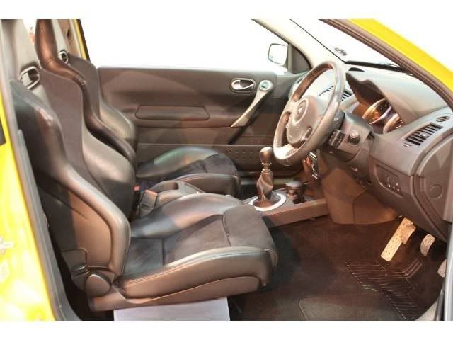

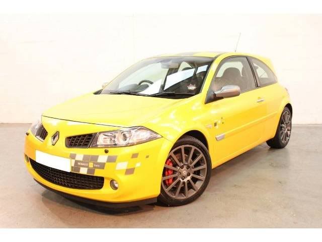

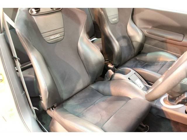

    I looked at a two standard R26's both up for £10k, a 2007 Ultra Red 07 plate and a 2007 Liquid Yellow 57 plate. Decided on the LY as it was same price, lower mileage 27k versus 34k, 6 months younger still in warranty and most importantly had xenon lights which were an optional extra.
    It was a two hour drive to see the LY up in Lichfield just off the M6 toll but worth it. It drove superbly so much quicker and more refined than the 172. Part of me wanted to keep the 172 but the problems meant it had to go and I was happy with the trade in value. It was almost due it's 3 year service so got a hundred quid off the price and put a £500 deposit down straight away.
    Pictures from the advert
    I collected the car the following Saturday on 27th November (bit sad I remember dates like that tbh). It drove great on the way home, tried out the power on the M6 Toll getting well into three figures and handled well on the B road to village were I live.
