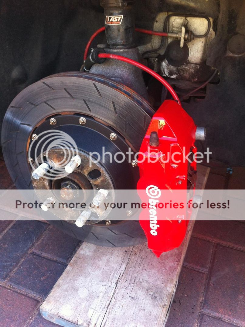

  5. [​IMG]
    PF 330 kit on my R26.R, awesome brakes along with DS 1.11 pads you'll not get much better
