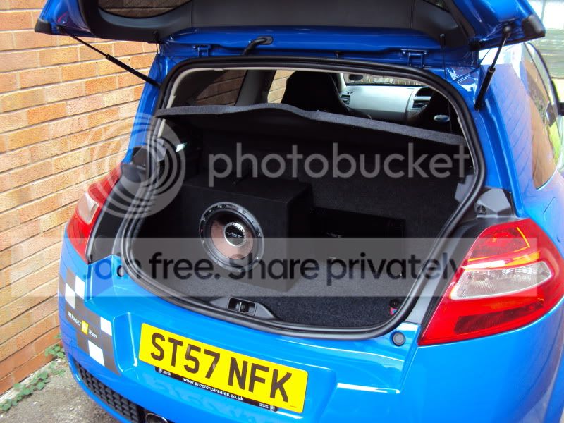

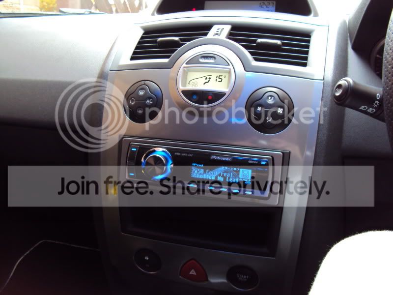

    Head Unit + Sub Fitted

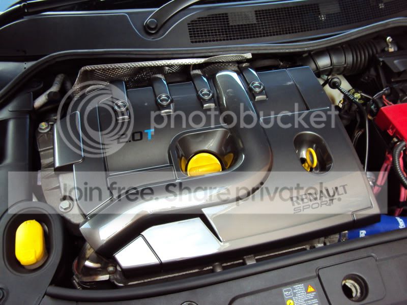

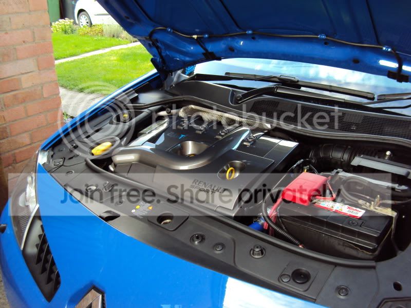

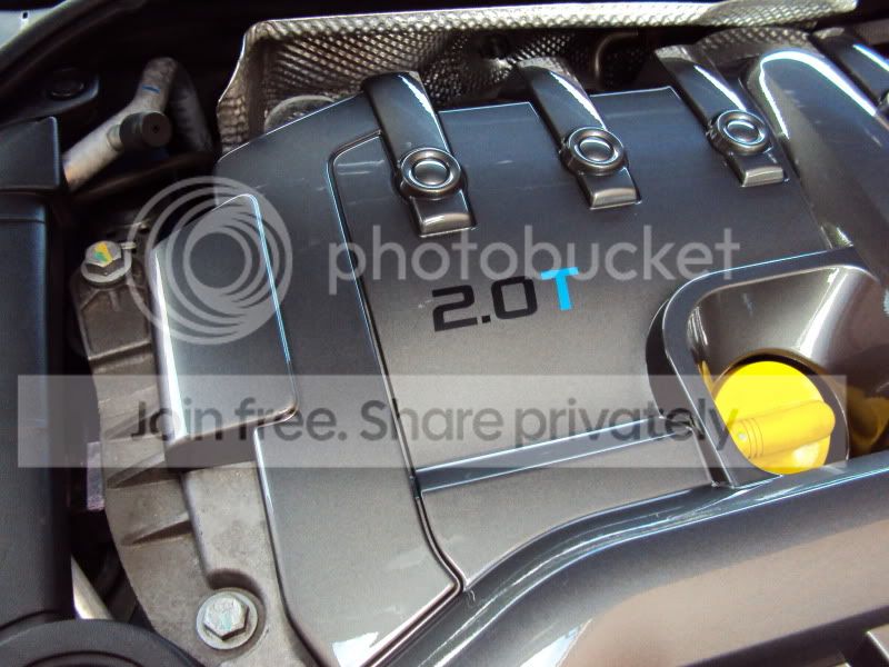

    Engine Cover

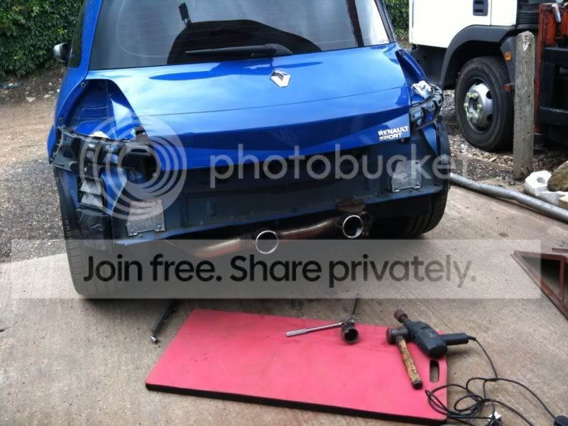

  3. Back box chop done.

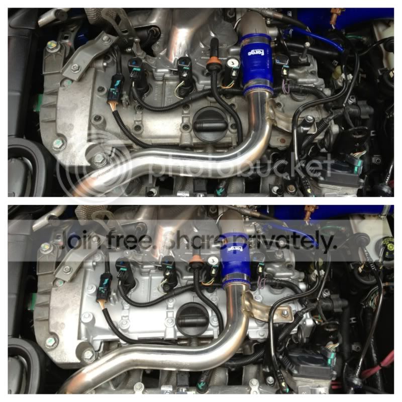

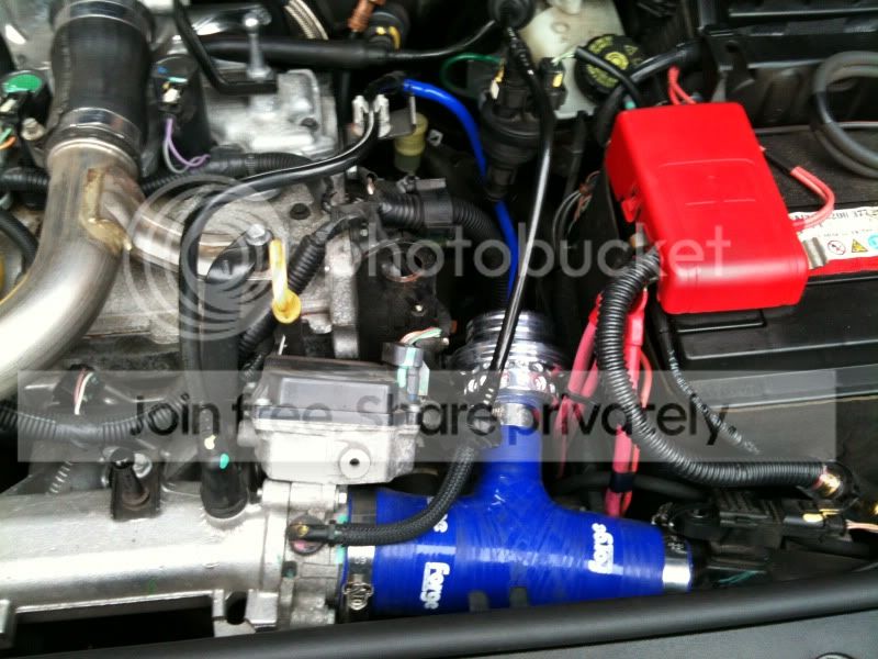

    well removed my forge dv and fitted a straight forge pipe and have yet to fit my air box forge pipe
    And Fitted

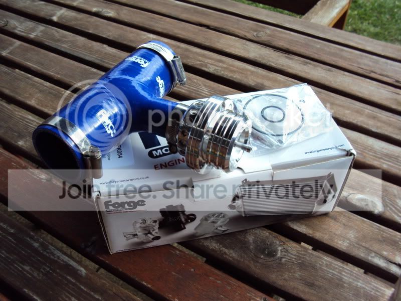

  6. Forge Valve

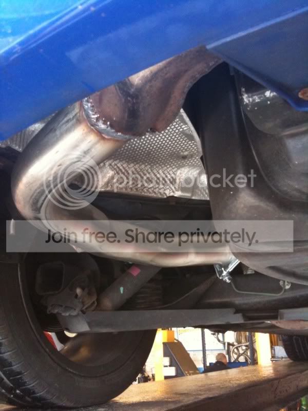

    Well finished fitting them today... Had a few issues with aligning the tips up so made some spacers up for the exhaust mounts and look about as good as a Renault can get :-@
    And the money shot :-/

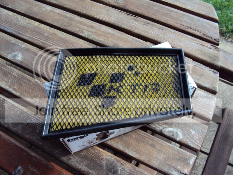

    Just fitted new injectors and some from mud guards

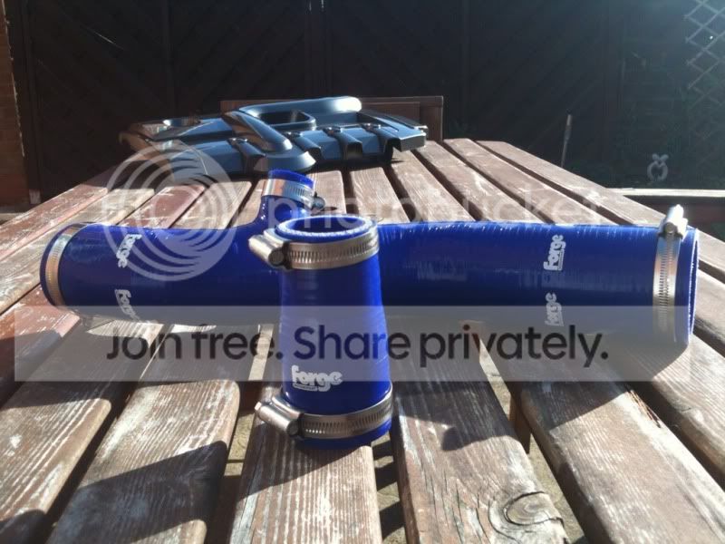

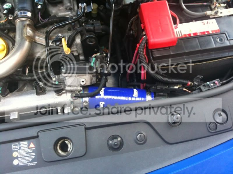

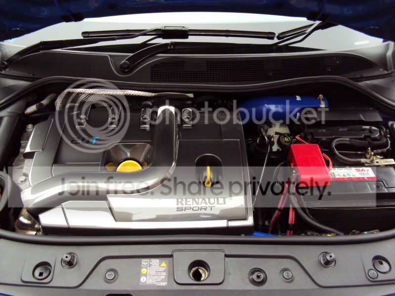

    Well I was deciding between the ITG kit and the K tec kit and this one from davidh blog.
    After sending a few pm's to Davidh I decided to go with this one with a Forge 90 degree reducing hose and a forge hose joiner and the ITG jc60/73 filter.
    Thanks to davidh :-) will be fitted soon. Total cost £85 with new hose clips
    After messing about with the kit a few times I'm happy with it and a few pics of it fitted now.
    It's not a noisy as people say after a few miles with it but it pulls so so much better up the rev range now.

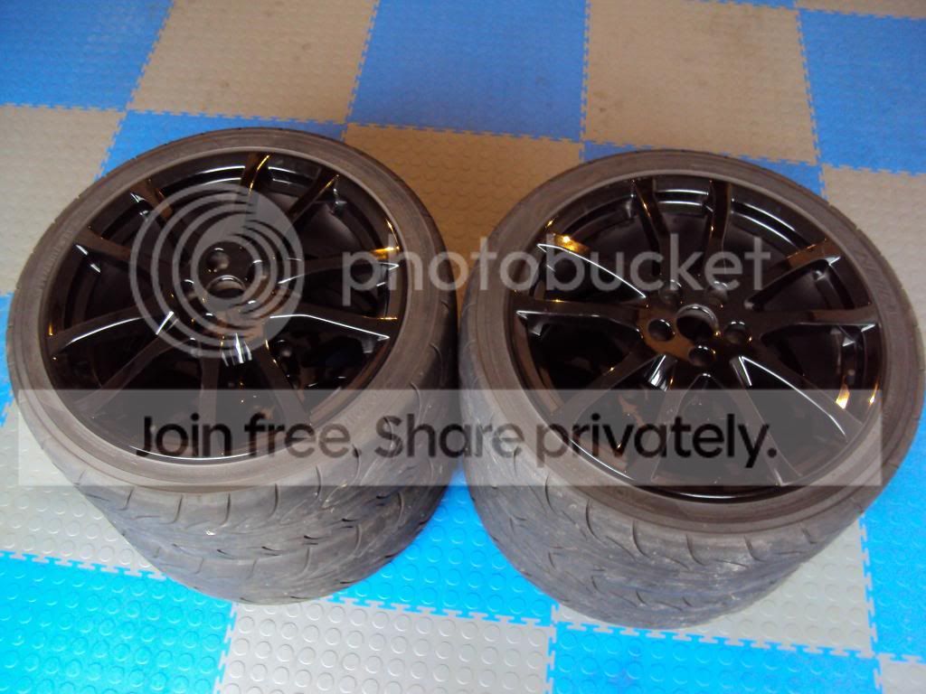

    Another step closer to what i wanted for the meg, i was after OE wheels or the R26R wheels and these came up pretty cheap.
    Want to get them refurbed but not sure what colour??? Anthracite or Fluorescent Orange?

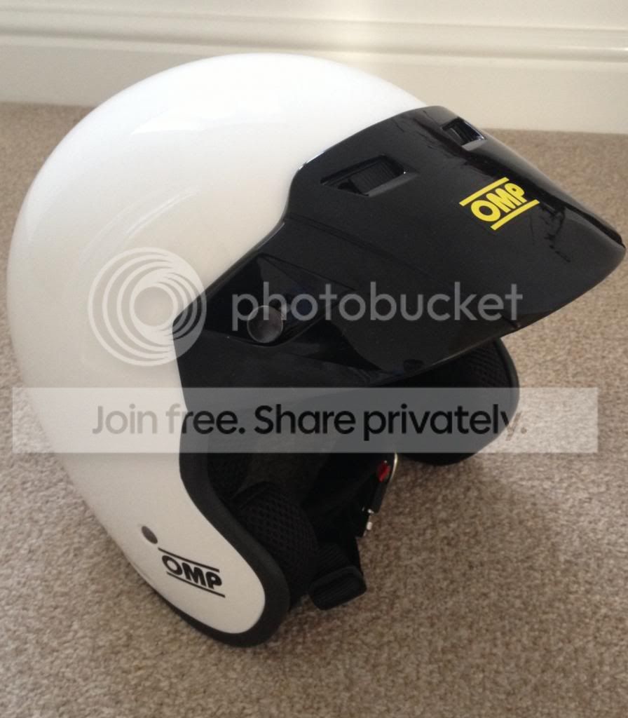

    And a helmet for track days i wanna start doing next year

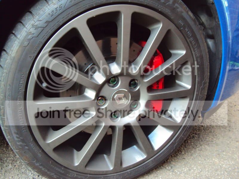

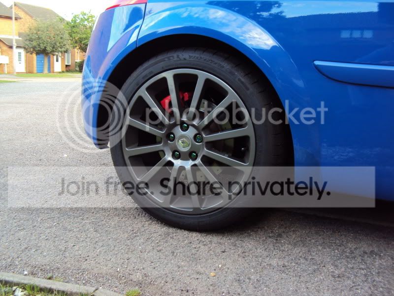

    Well got my wheels back fully refurbed in OE anthracite and they look spot on,
    Just ordered some planet polish wheel seal + shine for better protection from brake dust.
    Wheels all sealed up with planet polish wheel seal + shine and wrapped up in they bags.

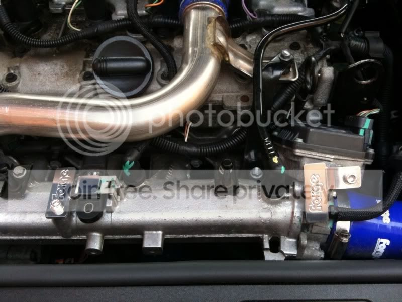

    Forge actuator turned up today
    Actuator fitted thanks to Ed
    Booked in with Rs Tuning on the 3rd may for a run and tweak
    @ RS Tuning today for a tweak after my mods fitted but Paul didn't touch it as it was all running perfect, so was just a power run, Made 7bhp.
    Fitted my actuator spot on and boost holds for longer now and can really fill it.

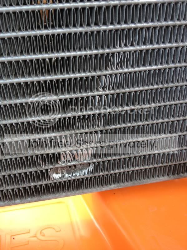

    Next day delivery on a new radiator from fastrads
    Think I have a minor leak so might as well change it over (hopefully its the rad)
    Cheap @ £62 posted but a few have fitted one and no complaints yet, 2 year warranty as well.
  10. Had my rad fitted thanks to Dan Lewis, took us a hour from start to finish so very good timing. Turns out there wasnt a leak but some damaged fins from a jubilee clip i lost over a year ago from removing the dump valve lol it had stuck itself to the rear of the radiaror a was rubbing in a few places

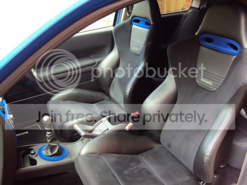

    These turned up today

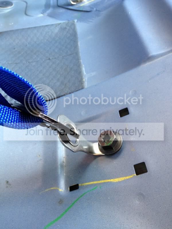

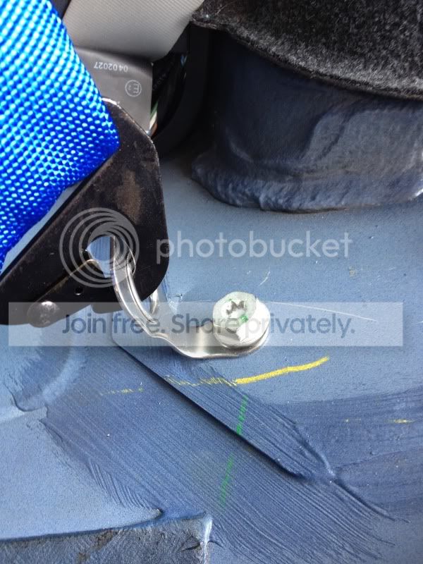

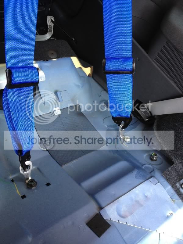

    Trial fitted my harness today and fitted the brackets. Not a bad job really
    This arrived today at the cost of £26 all in :-/ £9 postage
    Saves scratching the flocked part every time I fit the harness :-0 anal I know lol
    Anyway removed my seats today and fitted the rear brackets and then took it for a hoooon :-) fills so much better than standard belts

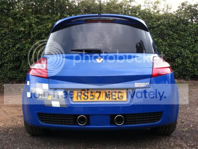

  26. Just replaced all 3 exhaust mounts

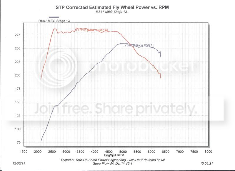

    @ RS tuning again today and had 630 injectors fitted and a map and made some nice figures over my stage 1
  27. Lovely graph mate! Jealous of the power! How does it feel over stage 1?
  28. Fantastic lol pulls better and gets up quicker :-)
  29. Will.
    Nice graph! I'm looking at getting a map at RS tuning done soon. What's needed for stage 2? Decat, injectors and....?
  30. Intercooler really and depends on your injectors as there good for stage 2 but mine where at 98% duty on stage 1 extra I suppose help figures
  31. Makes power quick! Maintains 300lb easy too, enjoy!
  32. Will.
    Intercooler. I always forget that one. Got a few things to do before the MOT next month before I can start the stage 1 / 2 work :worried:
  33. Fmic is a must, the std one is so so so poor, heat soak really quick (ive watched std ones lose 5bhp a run on the dyno!)
  34. IC, DP, Actuator and DV are the must on stg2, Nice graph
  35. Dump Valve isn't.
  36. I mean diverter valve (Recirculation valve) Helps on holding peacs. Is not but counts
  37. Ah right. Yeah I've got a forge recirc valve fitted and found the boost held it slightly longer than it did with a dump valve.
